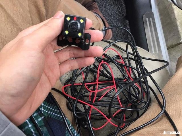

先瞄一眼这个小家伙,还带4颗补光灯,赞!
---------------The wiring steps are as follows---------------
Take a look at this little guy first, and he also has 4 fill lights. Great!

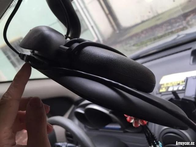

把插头先插在记录仪上,免得之后忘了
Insert the plug into the recorder first, so as not to forget it later

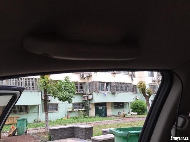

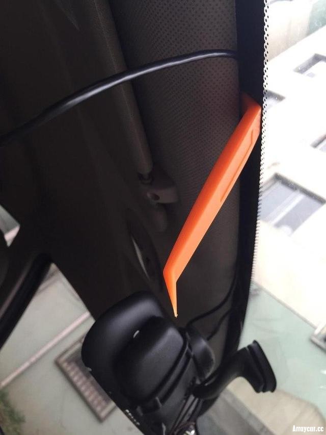

沿着前挡玻璃顶棚走线开始、
Starting from the front windshield ceiling

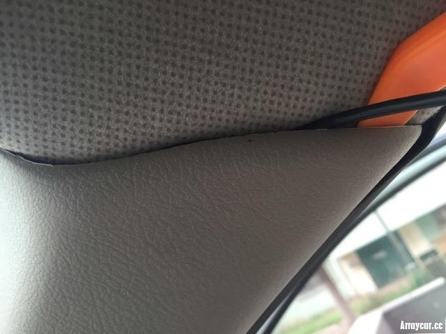

 楼主| 发表于 2024-5-15 14:59:08 | 显示全部楼层
沿着前挡玻璃顶棚走线开始、
到A柱,用小撬棒把线赛进去(小撬棒真心好用,不贵)
Go to the A-pillar and use a small crowbar to race the line in (the crowbar is really useful and not expensive)

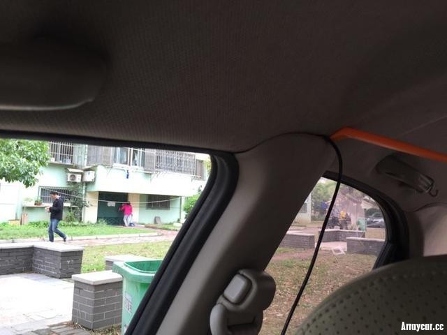

 楼主| 发表于 2024-5-15 15:00:29 | 显示全部楼层
继续走副驾驶顶棚,把线塞进车门处的黑色密封胶内,完美隐藏
Continue walking on the passenger roof and insert the wire into the black sealant at the door, perfectly concealing it
过B柱,继续塞进去,不要犹豫。
Pass through B-pillar and continue to insert it without hesitation.

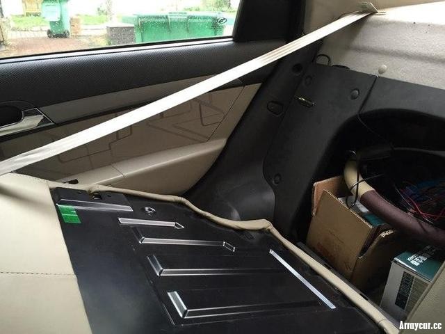

先走到后排座椅处
Go to the rear ceiling and continue to insert the wire into the black sealant at the door, perfectly concealing it
Walk to the rear seats first

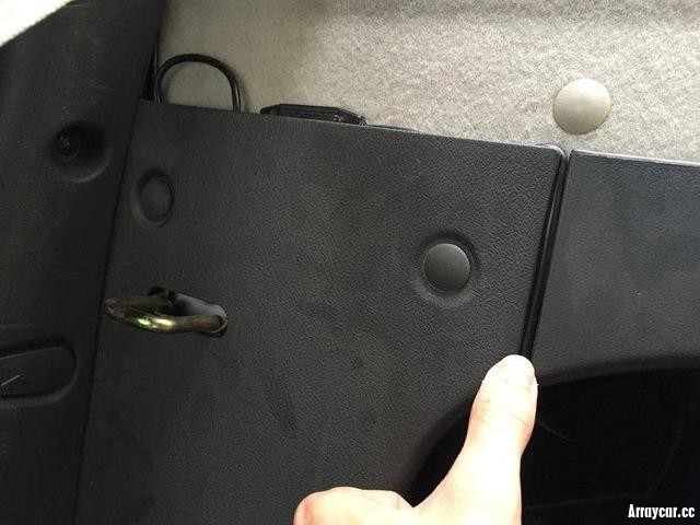

 楼主| 发表于 2024-5-15 15:03:15 | 显示全部楼层
先走到后排座椅处
把座椅向前打开方便之后的操作
Open the seat forward for convenient operation afterwards

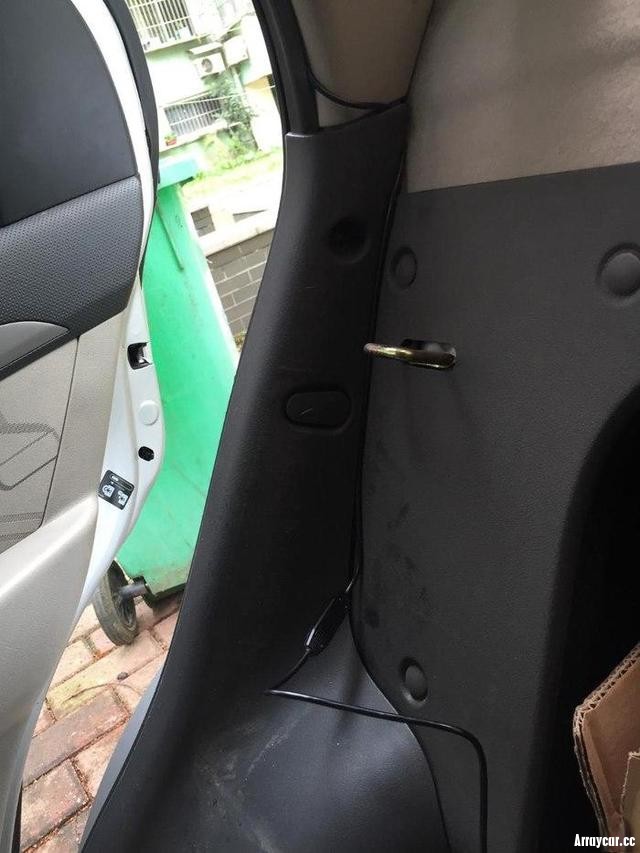

 楼主| 发表于 2024-5-15 15:03:58 | 显示全部楼层

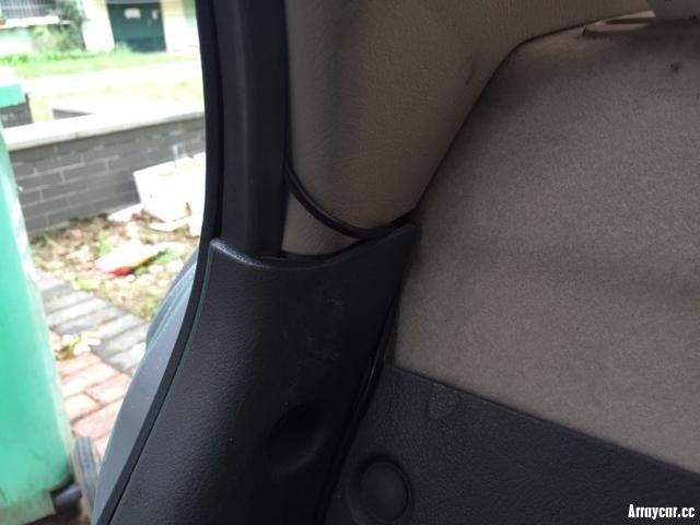

有的网友这里是拆掉卡子,把线从里面过去,我没拆,直接外面走进去
Some netizens here remove the clip and pass the wire through the inside, but I didn't remove it and walked in directly from the outside

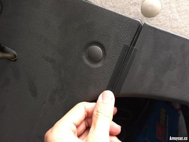

 楼主| 发表于 2024-5-15 15:05:12 | 显示全部楼层
打算把线从这走进去
为固定,用黑色胶布固定下,完美
I plan to walk the line through here
To fix it, use black tape to fix it perfectly
